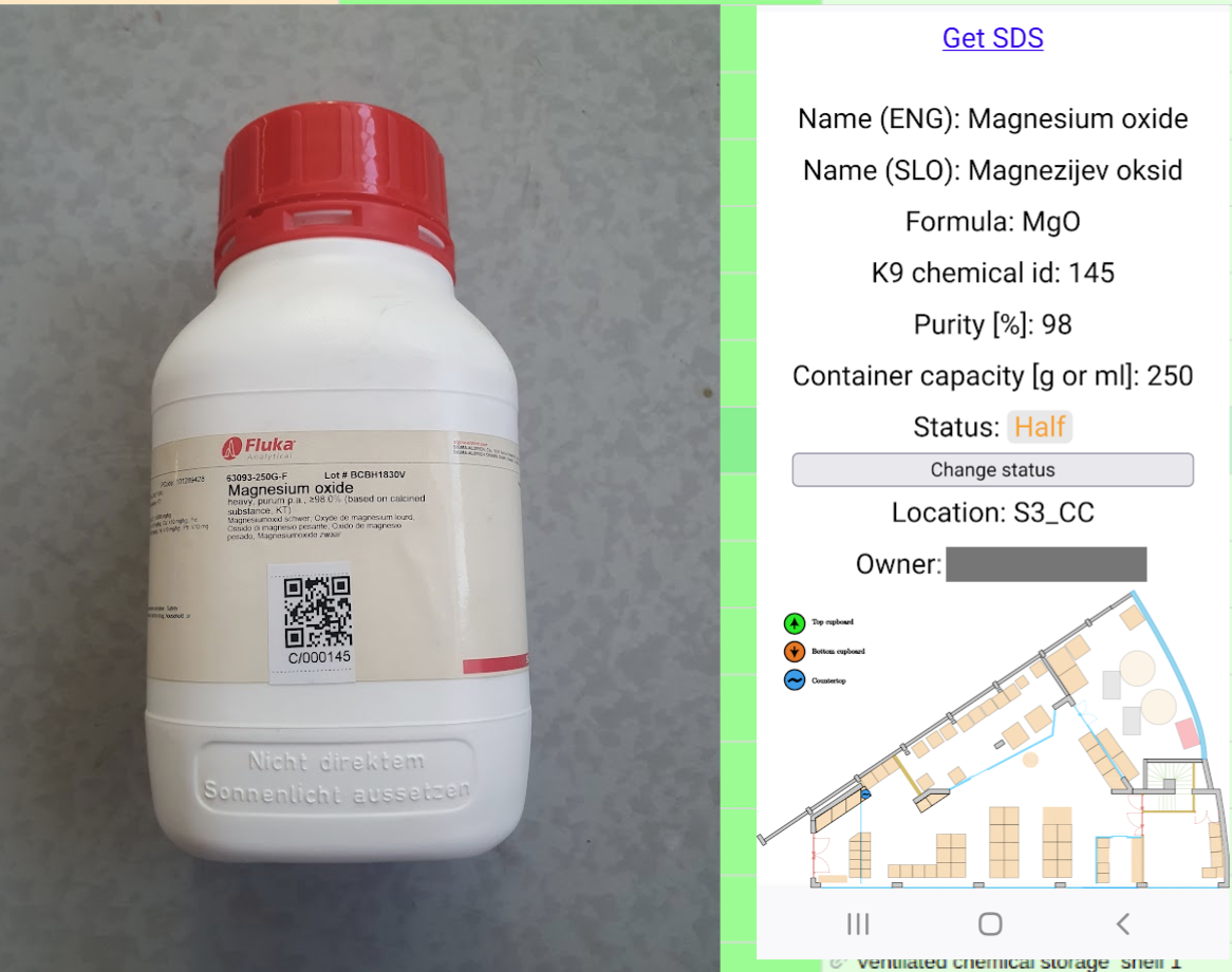

Managing ~1,500 chemical reagents presented both safety and traceability challenges. The previous system relied on manual record-keeping, which created gaps in custody documentation and complicated safety audits.

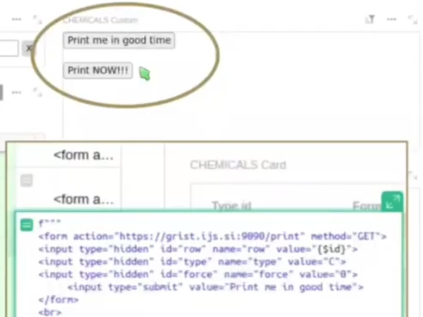

The Grist implementation centers on a searchable chemical database integrated with a QR code generator. Lab members use a mobile interface to scan labels and retrieve compound information, including location, quantity, safety data sheets (SDS), and hazard classifications. An automated webhook also parses the uploaded SDS to extract hazard information through regex pattern matching.
A custom print widget using HTML and Grist’s REST API to generate a QR code label containing safety data, general facts, and the location of any chemical in the lab.
The system provides instant access to safety data, streamlines audit preparation, and establishes clear custody chains for all chemical inventory, all while saving researchers “hundreds of man hours in the end.”

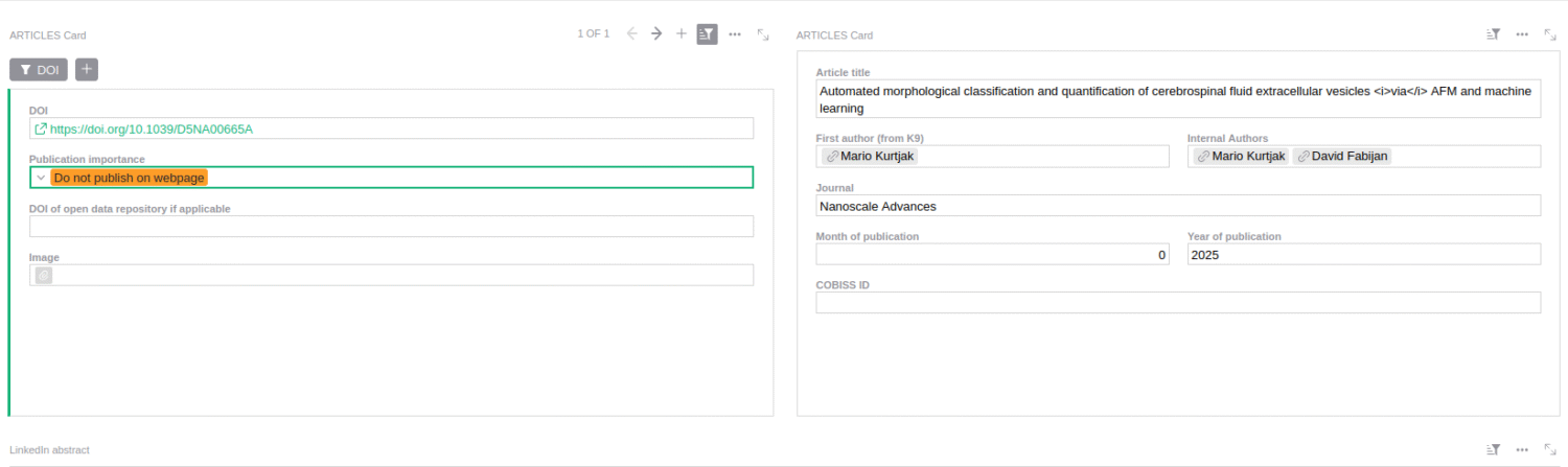

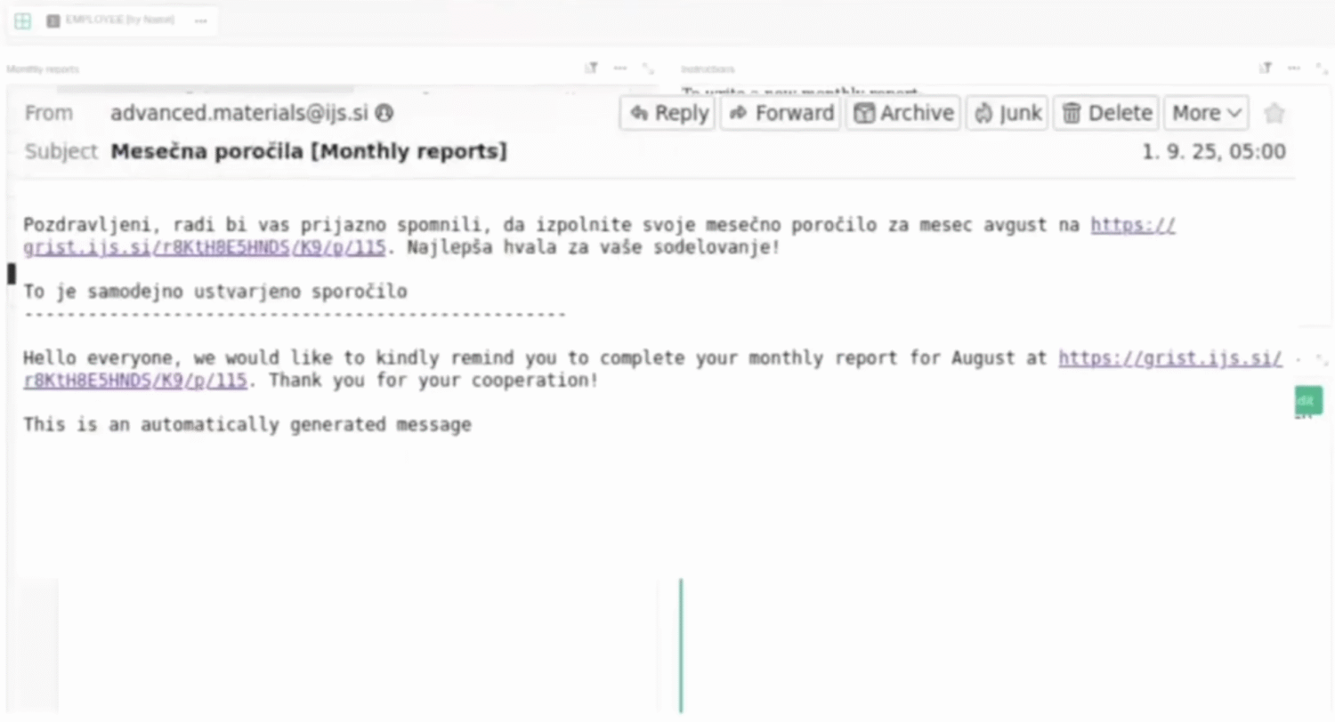

A custom-built lookup tool retrieves and normalizes publication metadata – or DOIs – with custom handling for institutional proxy requirements. An automated service checks when members haven’t submitted their monthly reports, and sends specific reminders rather than blanket requests.
The frontend view of the publication metadata lookup tool, showing article title, authors, journal, and time of publication.
An example email generated using the API to send specific reminders to submit monthly reports.

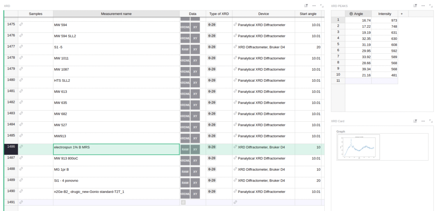

David established a standardized Sample ID protocol — the “Grist code” — that researchers include as metadata during data acquisition. A polling service monitors instrument outputs, parses format-specific data structures, uploads both raw and processed results to Grist, automatically associates measurements with the corresponding Sample records, and generates standardized visualizations.
This pipeline now operates for around 10 instruments. The approach provides unified data capture regardless of instrument vintage and eliminates the common problem of orphaned data files on individual workstations.
Table tracking data connected to Jozef Stefan Institute’s X-ray machine.

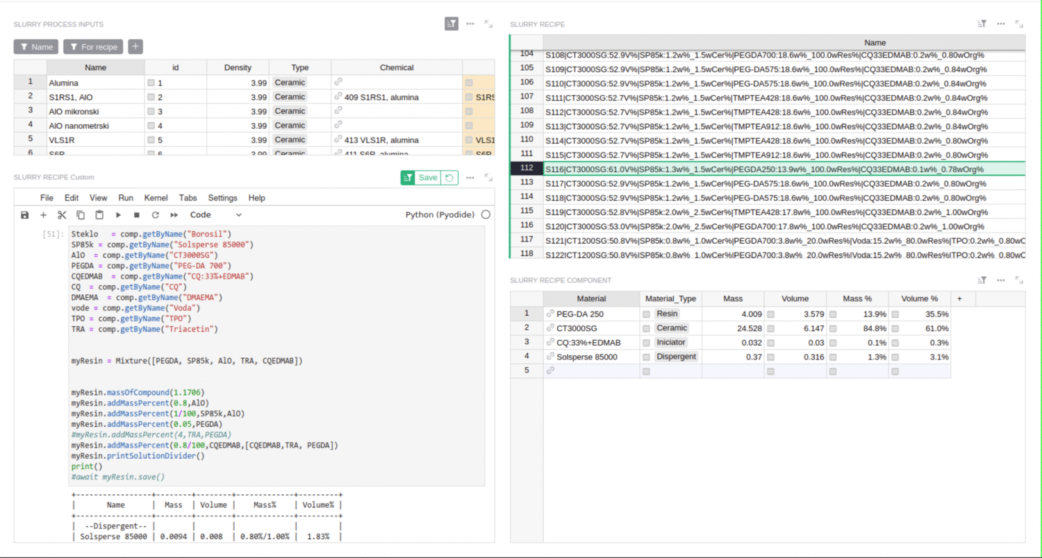

And here’s David’s favorite part of “‘Gristifying'” laboratory operations: students learning to prepare ceramic slurries (material recipes for 3D printing) typically receive informal guidance about material ratios that “work well.” Hardly a foundation for reproducible science.
David leveraged Grist’s integrated Python environment to develop process calculators that create these 3D printing recipes automatically. Users input target material properties and receive precise component masses and volumes calculated through linear algebraic methods.
Similar calculators now support laser ablation processes for thin film deposition and classical sintering workflows. The tools accelerate training for new lab members while improving experimental consistency.
David’s complex ceramic slurry tool, complete with material names, mass, volume, and composition within each recipe.
